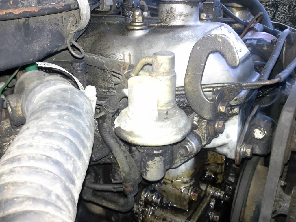

Somebody put some kinda putty/epoxy on mine at the top of the tc where it meets the head. anyway it squirts oil when you rev it up So it didnt work. Just replace the head gasket
You can kinda see it in this picture its the gold stuffName:  20130423_182509_zpsa45bb21d.jpg
