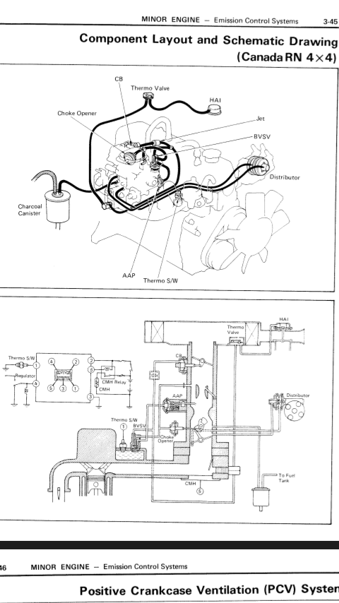

I've got an 83 4x4 with all the California emissions stuff intact. It takes awhile to go over everything, I'd recommend downloading the fsm in the stickies if your gonna go that route, it'll cover everything and how to test it. But the Aisin carb works well when it's properly tuned/functioning. It's also known for its off road performance. I've never fiddled with a Weber on the Yota but I've read if you re-jet and tune you should be good to go. Think lce makes a spiral adapter for it too.
The other thing to consider might be switching to Canada 4x4 emissions. It still runs aisin carb but with much less emissions equipment, looks like this:
I had an 83 FSM, 83 pickup. I also downloaded almost a dozen images from online of carb diagrams. NONE matched my carb. I could never find a diagram that could tell me where each hose, each connection went.
My 83 with the aisin worked fairly well with as many emissions ports plugged off as I could get at without doing a full de-smog.
