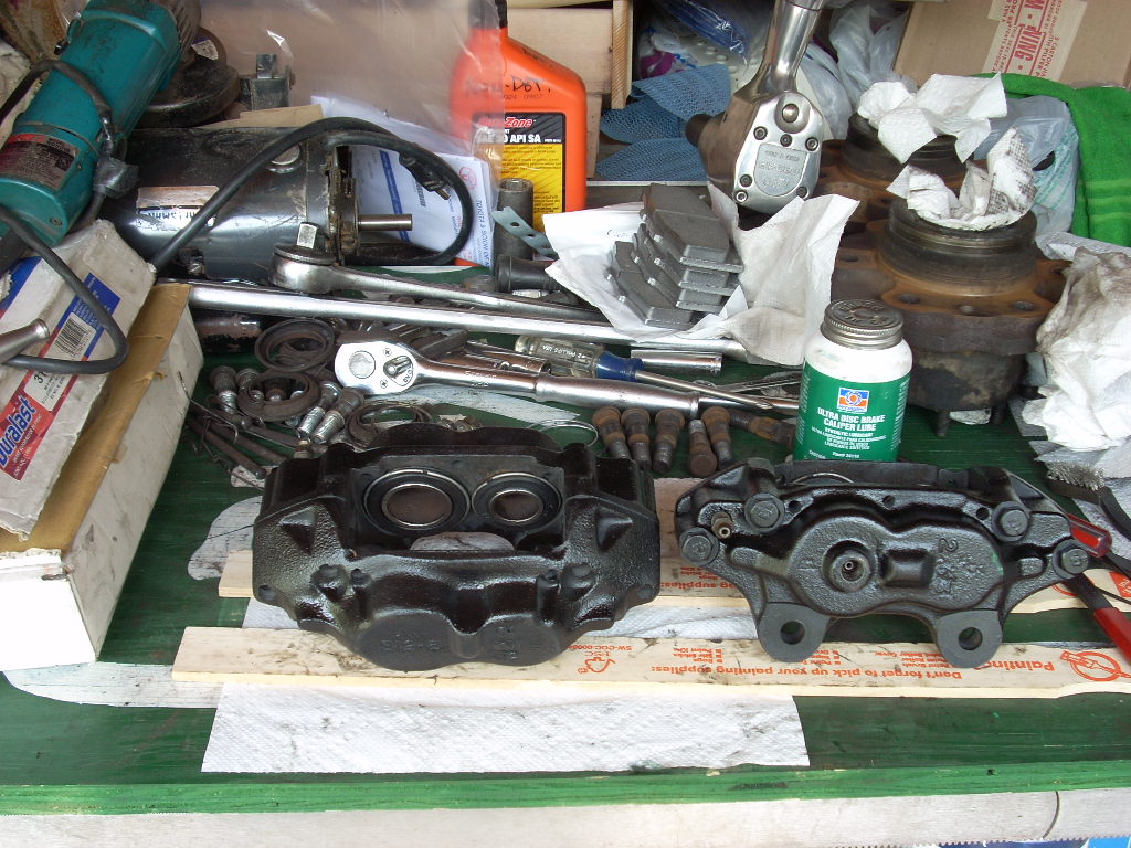

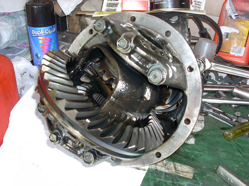

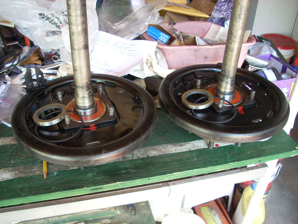

Get a service manual if you dont have, think its downloadable on this site. I agree, bearings locking up or dry can leave you stranded. Not on my 4x4 but another veh. the lack of or just old wheel bearing grease and was like locking the brakes. Had to use a acetylene torch to cut off the bearing race from spindle, I was lucky to be only 4 blocks from home. If you want a reliable & safe older truck theres lots to check out, I'm still checking mine out after 12 years. Dont forget the rear axle seals, check diff and TC output seals for leaks. Stay away from mud if possible. I try not to go through anything deeper than a foot and take it slow. Pack the steering knuckle full with the black stuff, moly lithium. Hit all lube points and dont forget the universal joints. Good luck
Pics for your viewing enjoyment, LOL
Attached Thumbnails HOT hub, weird sounds, pulling and caliper leak-toyota-brakes-001.jpg   HOT hub, weird sounds, pulling and caliper leak-toyota-diff-brake-005.jpg   HOT hub, weird sounds, pulling and caliper leak-toyota-diff-brake-008.jpg
