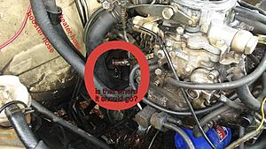

To preface, this is a calif. truck that every time it gets worked on more smog crap gets pulled off since its no longer in CA.
i've looked at the idiot book, spent three days on forums, to no avail. now asking it myself

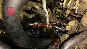

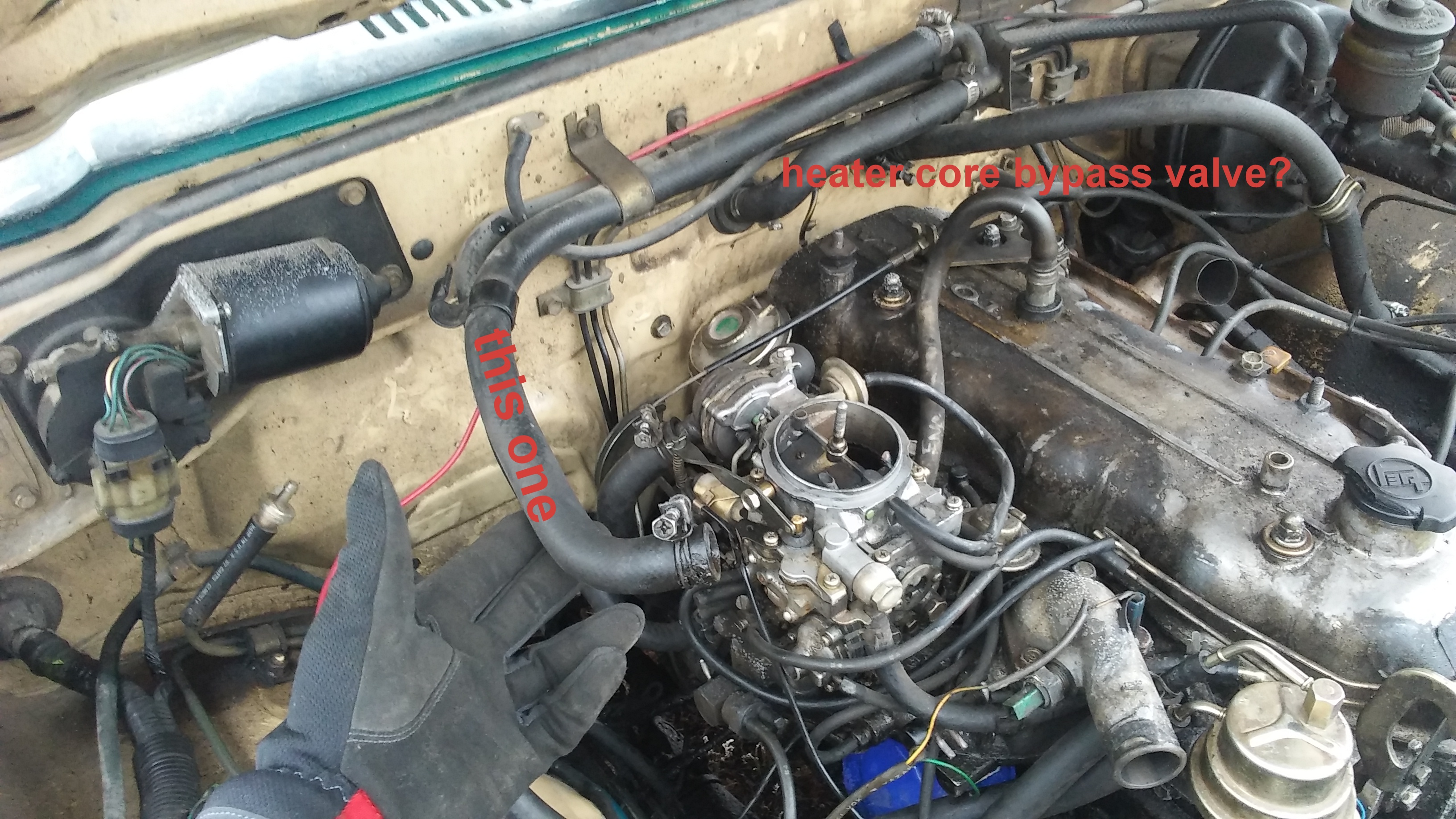

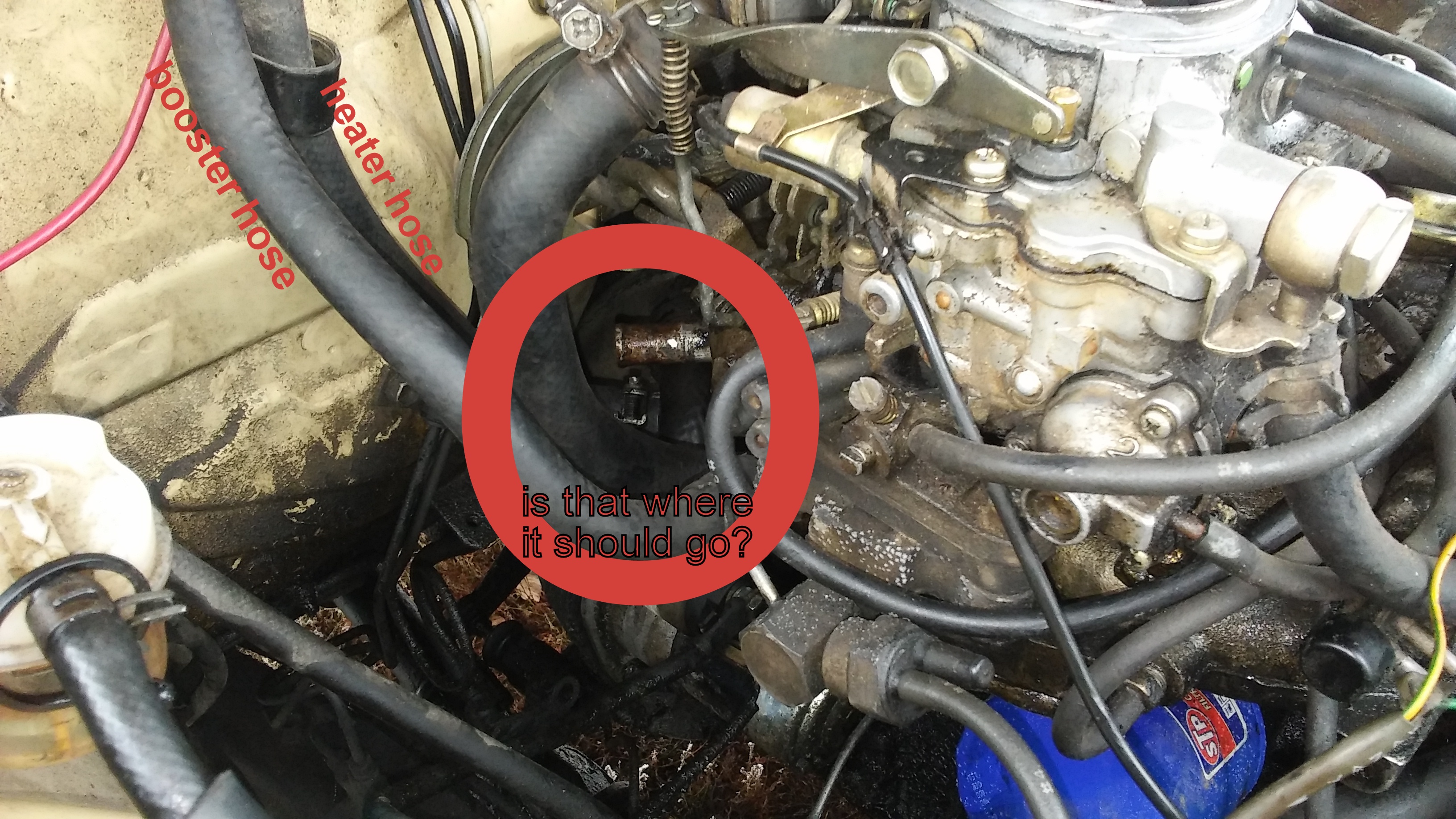

If you're just asking about that hose that's exactly the size of the connection sitting there with no hose attached, having exactly the right bend to fit the connection...yes, I'd say it goes there. If you're asking about something more, try to be more specific. I'm not trying to be rude...I know how complicated carb connections can be, and how hard it is to find the right diagrams. So I've kinda learned...if it looks like it was meant to fit together, it probably fits together. All I can see that you're asking about is the hose that looks like a small coolant hose, disconnected from the pipe right in front of it. Loose hose, empty connection, right next to each other...that's where it goes.
If you're asking what it does...I dunno. My experience with carbs is that coolant will only be routed through them if they have a water choke, but my experience with carbs is limited and fading...
Good luck!

thanks mate, i just jammed on and no leaks

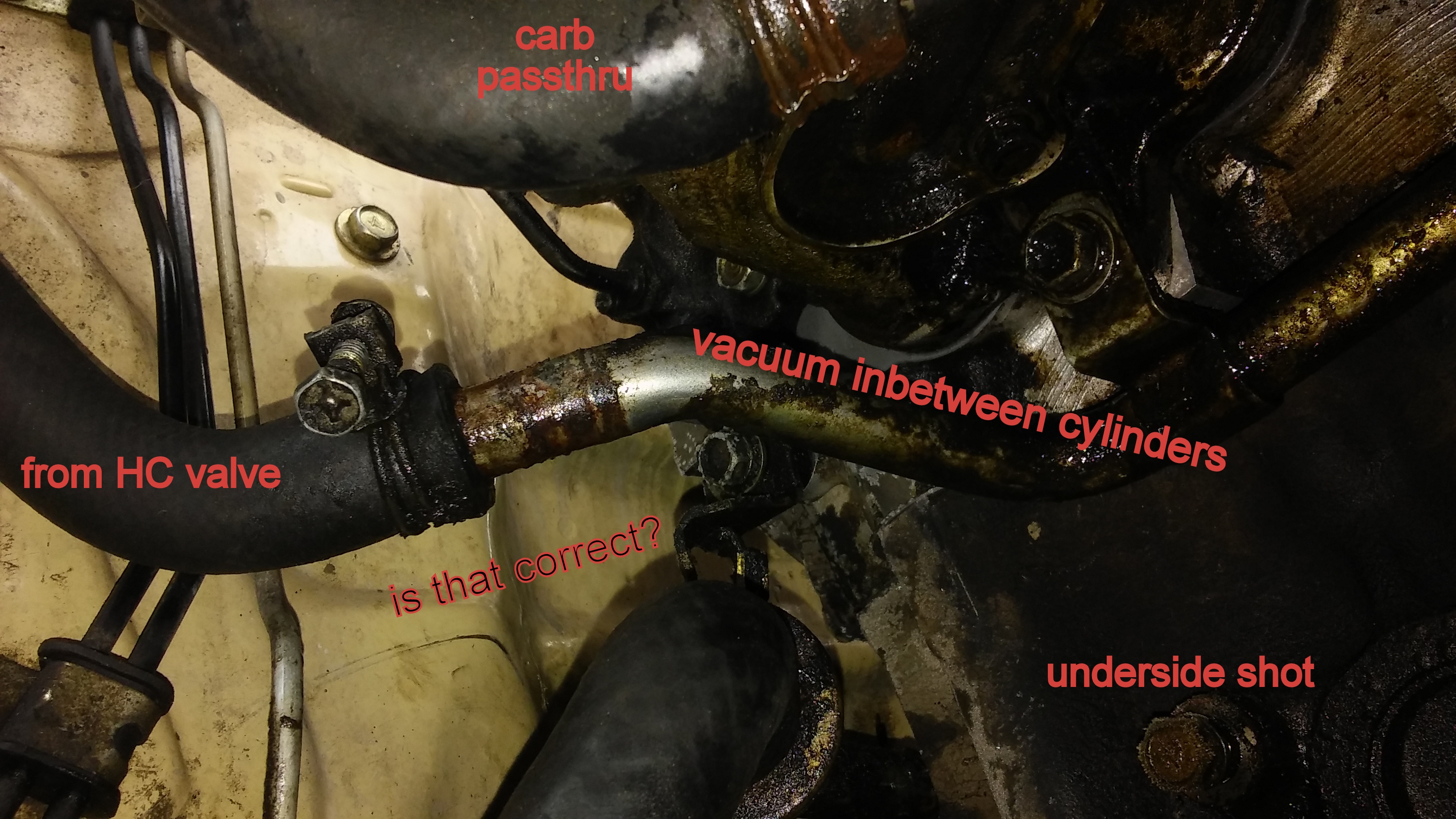

The loose hose is the heater hose, and it goes to the fitting that is sticking out. Tighten the clamp so it doesn't blow off when the system pressurizes. The fitting isn't vacuum, it's water.
