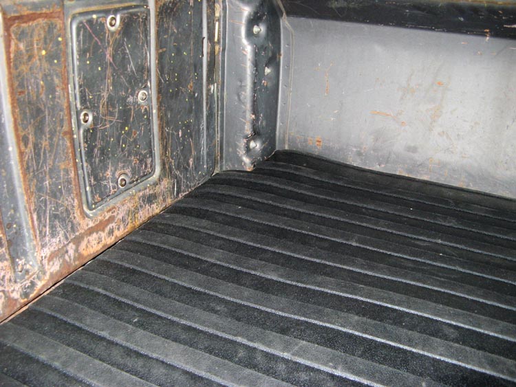

Full coverage!
The Protecta bedliner mat for Chevy full size pickup worked. In fact, the width was a perfect, snug fit. I reversed it compared to Chevy install (front/back), and trimmed off excess:
It rolled in like it was a factory fit. Nice.
It was easy to cut with a utility blade holder knife and a metal straight edge.
Here's the left rear corner under the brakelight/turnsignal box
It fits better than the one I bought for my '94 shortbed years ago. It seems like the same brand. Nice and heavy.
