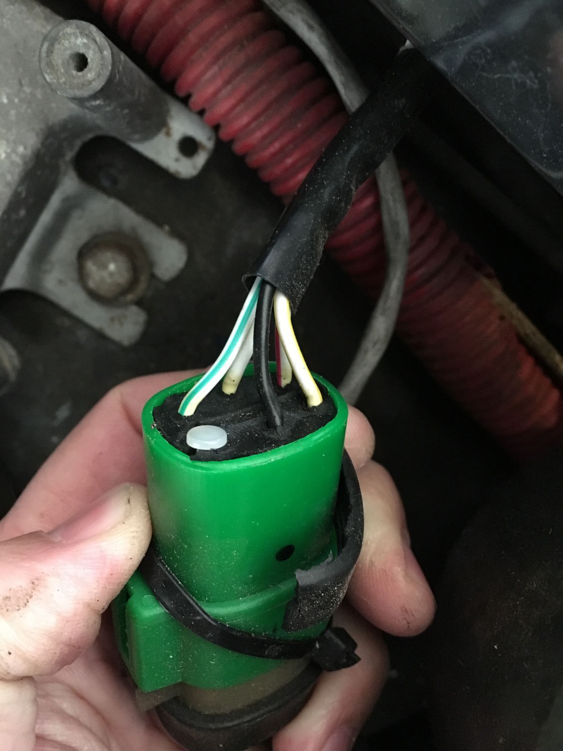

KB83 Dec 10, 2017 09:19 AM
Originally Posted by RAD4Runner (Post 52384703)
​​​A picture paints a thousand words.
Let us see what you have in front of you.
Difficult to tell or guess without seeing the regulator and/or schematic. If you do not know whether you have a stock regulator or not, OR if you do not have a schematic, you would have to do your homework of tracing those wires from regulator to battery or to ignition switch, or to the fuses.
There should be these wires going to regulator:
IG- from ignition switch (IG on) - this provides excitation (i.e., seeding the alternator). Red in 1986 and later.
S- Sense wire. usually white. goes directly from battery (or fuse that's always on) to regulator. Always has exactly same voltage as battery.
L - Fault aka "charge fault" wire. yellow in 1986 and later. When IG is on, this is low. When good alternator starts working this goes to 12V.
https://cimg8.ibsrv.net/gimg/www.yot...8d6655bff7.jpg
https://cimg2.ibsrv.net/gimg/www.yot...64a7b0a1a0.jpg
I found a manual for it so I’m looking through it now trying to chase this down. What does IC mean in regards to the regulator?
WolfMann Dec 10, 2017 12:21 PM
I've heard of people running a wire straight from alt to bat and getting around the regulator like that. But then I suppose you run the risk of an overcharge. That regulator looks almost new, also seems to be a 40amp 5 pin connector, I think that's A circuit. Check the three letters at the port on back of alternator, they'll be different depending on what type it is. If you have a B Circuit alt on an A circuit regulator it won't charge right.
KB83 Dec 10, 2017 01:13 PM
You are correct, it is s brand new 5 wire regulator. It’s a duralast VR765. I know that because I found the box in the cab with the old one in it. The more I look into this the more it appears to be a diy hack job with a shoddy audio install and everything. The charge light doesn’t look to be working either.
How would I know if it’s an A circuit or B circuit?
WolfMann Dec 10, 2017 05:29 PM
5 pin connector, and there should be three letters where 5pin connector plugs into alt. (Back of alternator) I would check those first and make sure you've got the right alt. I can try to take a look at mine sometime tomorrow (dark now) It's also 5 pin a circuit. But a Google search may tell you sooner.
