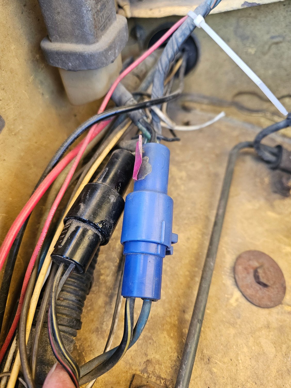

83 22r, new ignition lock cylinder
I ended up swapping out my ignition lock cylinder, the part that triggers the ignition switch was plastic... so it was warn down. Now it has a strong crank. $38, out the door, on partsgeek.com. I would test the starter relay as well. It's cheap to run a fused line directly off the positive post on the battery to the relay. Test the ohms on the relay first. Black with white strip and black. The 2 biggest gauge wires
83 starter relay, it has 2 plugs Blue is high voltage Black is relay wiring
