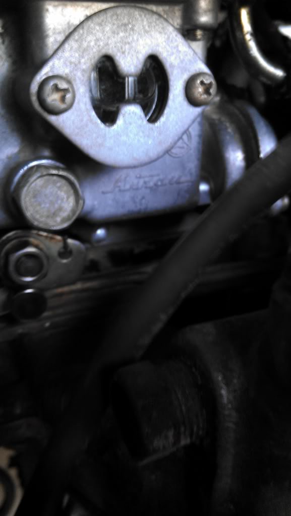

Now when you guys say the fuel is visible through the sight glass what are you referring too?
The see-through fuel filter?
I watched the filter while the truck was idling normal an it was about half full.
Then watched it while it was running like crap an wouldn't idea an it was the same level... I cant seem to figure out what causes it to act up. There is no patter....
Typically I believe the fuel level on the carburetor (front side of it) is supposed to be no higher and no lower than the two phillips head screws on the sight glass. In my picture you can see its at the bottom of the screws.
