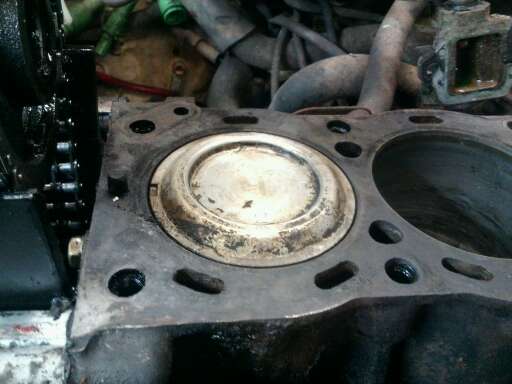

I swore I read that 81 22r's had a single row chain and a plastic guide...mine is double and metal. Also, the top of my pistons have a raised rim with a recess in the center, like a pool. Anyone familiar with this setup? Oh, it's a california model, if that makes a difference. I'll post pics as soon as I figure out how. The question now, do I slap the head gasket on dry, or do I put a bead of head gasket sealant around the rim?

If I recall right the 22r had dual row chains till 82.

81 should have been the last year with dual row chains, IIRC.
The piston tops sound right.

Mine are slightly different...but that dual row chain makes me happier than a 12 point buck in a bulletproof vest!

my 82 is dual row with those pistons.^
