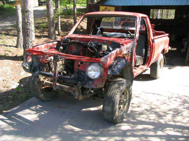

Pic of the Truck
This is the truck when it was dropped off this past Saturday

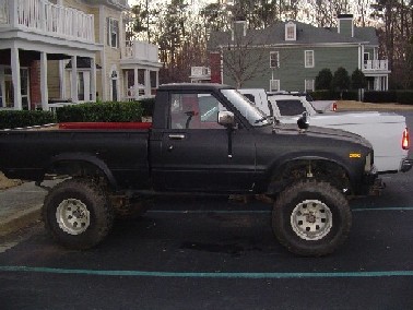

I think we have similar rigs...gotta love the flared 79-83 rigs. Bought for 1250 us dollas$. Found most parts used on ebay (turn signals, sr5 dash etc). Trying to attach pics of the original color! Sounds similar to yours. BTW Kyle_22r is a good source for info. I Lived in Lanai, HI for 1.5 years and fell in love with the early flared federed yota's...paid too much for mine, but now I have one and could care less
later
Ryan in GA

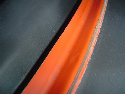

Attached Thumbnails 1979 Shortbox Fun!! Build Time!-resize1980-1.jpg   1979 Shortbox Fun!! Build Time!-resize-1980-orig-paint.jpg

Well as you can see from the photo, I have the original doors and fenders in the back bed. The bed needs to be amputated badly, it's been smashed AND is rusted. I would have saved the bed and done the bodywork if it wasn't rear ended. The fenders need a bit of work but it's all drivers side. And yeah 80 Mini, that's pretty much the same paint. The only things that I'm really missing (prior to me getting the engine in there, LOL!) are a Passenger side window, Windshield, Hood, Passenger door hinges, and front clip. Not a huge list..... I'll be updating my progress after the weekend and post some photos of completed work.

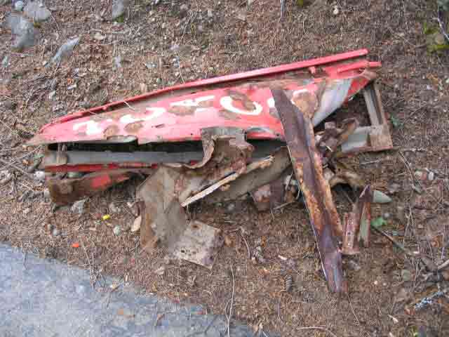

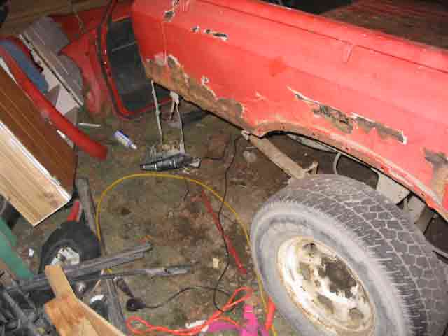

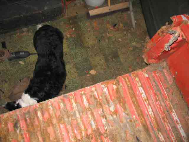

Okay, so I've done what I could over the weekend without having to take a run into town, but next week I promise that even more will get done!! I'm going to post a few photos, none of them are "before" pics though...kinda got into it and didn't think about taking a pic until after I put the tools down The first photo is of the metal that I cut off of the back bed. At first I thought that I would just pull it and make a bed but then I got thinking that I really want a Toyota hook bed on the back and I'd save it. I had to lose the tailgate, the panels under the bed just behind the wheels and the bed had to be cut back past the mounting hinges for the tailgate. It had been rear ended pretty good, but I managed to save a lot of it. The next photo is of the bed after it has been trimmed up and cleaned a lil. It's going to need some MAJOR bodywork, but I can do it, and it's cheaper than buying something else to replace it. And finally I'll just put another pic in of the "sides" of the bed where I had to get rid of the panel between the tire and the tailgate. Both sides had been smashed when the truck got smacked and not only that, but the rust had eaten them up.
So there everyone has it!! Next week I'll be taking on replacing some shocks and maybe a rear leaf spring or two so I'll remember to take a few pics BEFORE I do the work, so I actually feel like I've accomplished something!
Attached Thumbnails 1979 Shortbox Fun!! Build Time!-tailgate.jpg   1979 Shortbox Fun!! Build Time!-trimmed.jpg   1979 Shortbox Fun!! Build Time!-trimmed-side.jpg

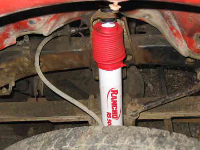

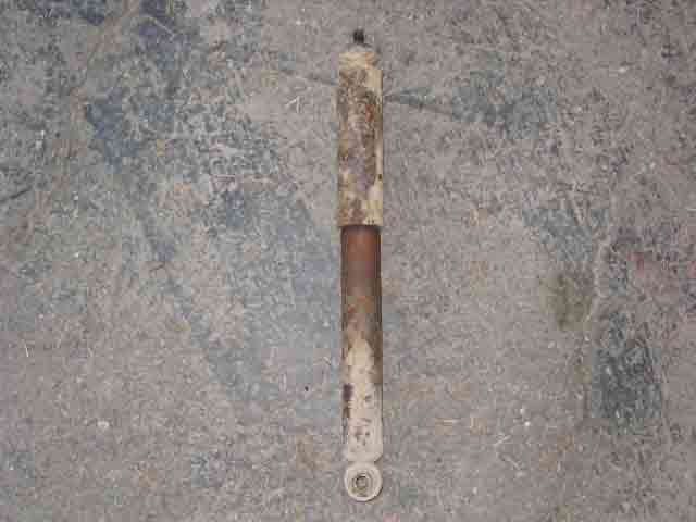

Okay, so I didn't get a darn thing done this last weekend except source out a few parts for the truck and I took a good look at the hinges for Slacker and they both appear to be in fine condition. Send me a PM with the "deal" and we'll work something out Other than that I've got a couple photos of one of the shocks in there and the old super junky shock that came out!
Attached Thumbnails 1979 Shortbox Fun!! Build Time!-shocks.jpg   1979 Shortbox Fun!! Build Time!-old-shock.jpg
