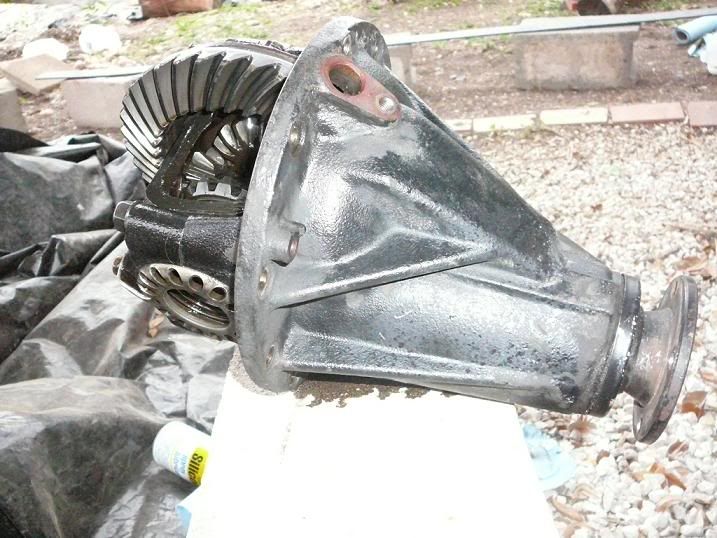

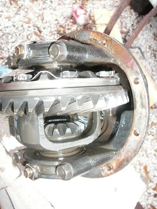

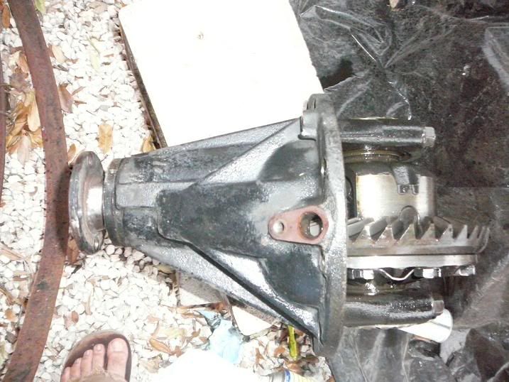

Got this guy off a '92 4Runner, 2WD, Automatic, V6, sticker in doorjamb said 225/75's, but my truck says this as well but came with the 31" tire package.
I've spun the driveshaft side in an attempt to ascertain the ratio, sadly it looks like a 4.30 or even 4.10. I was wondering if this is the 4.88 which according to another thread has a totally different case and is either impossible to change the gears in or it can't be done at all because the case is different. This one looks slightly different then mine but I thought I'd ask you all to lend a hand.
<br>

I just counted the teeth, ring has 39 and the pinion has 11. I guess the PO had it regeared or something. This diff is wack, according to the R&P it has a 3.55 gear ratio. WTF? And it was dirty as hell, I doubt it ever came off that rear differential housing.
well you did say it came from a 2WD.....
4wds had the 4.88's your looking for
I see, the problem though is I've never heard of a 3.55 in a Toyota. Especially this model. So I checked the spiders gears and they're 16 and 10 teeth. So I thought multiply these and that gives me 5.68 so christ.
.....gear ratio comes from teeth on the ring and pinon, good chance you miscounted the pinion, a common 2WD gear is 3.90.....39/10
Yep, marked the ring with a marker numerically but didn't with the pinion. Damn 3.90s. So why'd did they gear the 2wd and 4wd so drastically different? Wouldn't the 4Runner feel slower then hell with 3.90s, an auto and V6?
