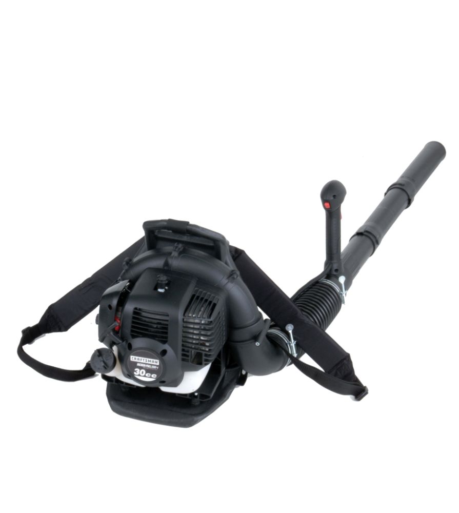

Hey I got an idea Why don't you mount one of these to your intake. you coulld control the throtthe with a cable of some sort.

there actually is a video online where a 1.6L civic dynoed 15hp more with a leaf blower attatched to the intake, but on our engines that wouldnt work, not enough cfm
