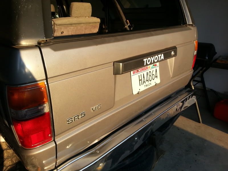

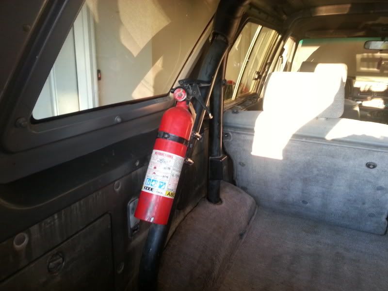

onto some pictures.
Click the image to open in full size.
Click the image to open in full size.Click the image to open in full size.Click the image to open in full size.Click the image to open in full size.Click the image to open in full size.Click the image to open in full size.Click the image to open in full size.
