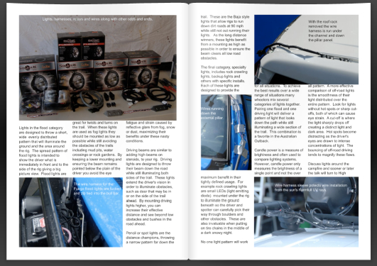

Install Roof Lights (gobi style)
Installed some Baja Design off road lights a while back. After all the digging into how to stuff, Toyota Bulletins and everything on the web I thought I would write it all up, put it into one location and save others some of the searching.
These lights are from Baja Design. They are better known in the two wheel groups so don't be surprised if you never heard of them but OMG my FJ can now turn night into day.
Here is the link to the write up, video and pictures of the whole process. You'll also find the other research material I dug up. Good luck.
