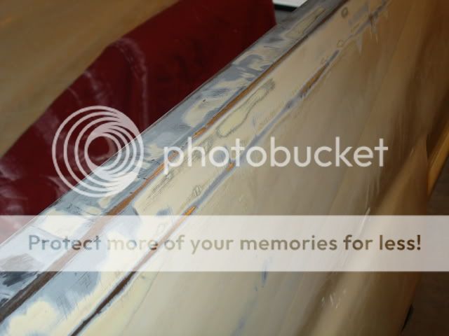

results are in
thanks for all the input! the results are in, i tried 3 methods with mixed results. sorry for the long post, i wanted to tell the whole story. just a quick summary: my problem was i had the bedliner on my rails and in the bed. i am getting ready to paint my truck, i was going to roll it but im now going to do a real paint job cause i have put a lot of time already into prep. i started by wanting to remove the liner from the rails without removing all the paint. well i was some what successful with that. several people recommended paint stripper. that is definitely the quickest way to go. i was hesitant to use the stripper on the rails though. if you strip down to bare metal on the rails then where do you stop? you would go to full paint to no paint which would require extra sanding and primer. if you mechanically remove the liner then you would have some original paint/primer left and would need to do less sanding and priming (in theory). first method i tried is a wire cup brush in my drill. that worked ok, it definitely removed the liner but also took a lot of paint if you weren't extremely accurate. you could keep from going to bare metal though. second method was a heat gun and a scraper. i used a cheap heat gun ($10 harbor freight) and scraper. this worked ok but like the brush was hard to keep the paint. it was a tough task to heat liner enough without heating paint too much. so often the paint would go with the liner. since i wasn't getting great results i traded the scraper for a flat razor blade scraper. that was quicker but still took most of the paint. so i used a combination of both but honestly cant say which was better. it was all in the technique which was hard to perfect. the rail behind the cab i tried the stripper. i used mar-hydre tal strip spray stripper. holy crap, that was easy! but surely enough it took all the paint too. that was ok because there was no other painting that was going to happen there so i didn't have to worry about blending together. so thats it. sorry i don't have more pictures but this one of tailgate is how it all looks. some paint, most of the primer, NO LINER.
i will coarse sand first to smooth it out then still do a couple primer coats to fill in low spots and then finish sand. being i will still have to prime some, if i were to do it again i might go straight to the stripper and just be careful to keep it only on liner. when i go to re-do the bedliner i will use a bunch of stripper and just go down to metal. but im painting first then doing the liner later. i agree with everyone that proper prep is key to any sort of paint or liner success. i will try to get a few more pics up tonight. heres my truck now except the fenders are off and theres no longer black liner on the rails! i hope to have it ready for paint by the end of the month and then get it painted in early july.
spokane.yota.man is offline   Reply With Quote

yeah yeah, everyone said stripper and i tried it last. it worked pretty good, i hadn't used stripper before and expected it to be a lot more agressive then it was. the heat gun wasn't too bad either though. this pic shows about the best i could do, its along a side bed rail.
someone with a little more patience could probably do a better job then i did with that method. this picture shows the bed side of tailgate with just spraying a few coats of stripper then brushing it off.
i obviously still have some scraping, it gets the job done but its still a bit of work. its also very foul smelling and burns a little if it gets on skin. im not surprised given what its suppose to do, so use in well ventilated area and wear the necessary protection.
