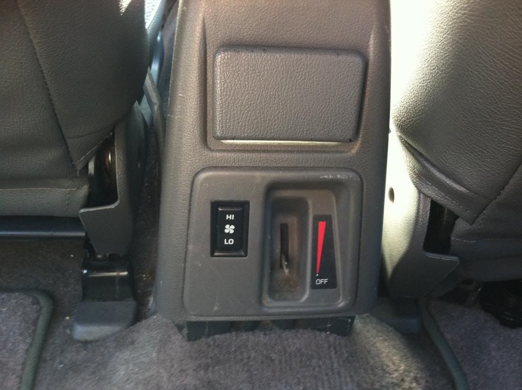

Okay I think I finally got it. Here are some more pictures, some interior ones. Also a couple of my crappy window tint which needs to go ASAP. Okay so I'm looking into the ball joint lift. How does it lift the rear? Also checked out the Zuk mod, doesn't look like there are any draw backs so I will be doing that very soon. I'm thinking a 2 inch lift should do the trick. This is my DD so I can't get too crazy, not that 2 inches is anywhere near crazy haha. Anyways thanks for all the info.

I need this switch
