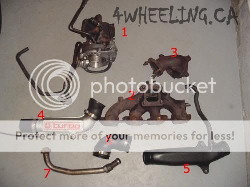

Does anybody know where to get a waste gate that attaches the ct20 turbo to the standard exhaust of the hilux 2.8 ln107 ??
turbo1-1.jpg?t=1290320819
I need part number 3

It should be internal...
Look in the exhaust turbine housing for a flapper door...
Old 11-21-2010, 09:55 AM
4runner4ever's Avatar
Join Date: May 2003
Location: the Netherlands
Posts: 460
Received 0 Likes on 0 Posts
It is an internal wastegate. The actuator attaches to the borrom of the impellorhousing.
I swapped a 3L engine, 2Lt turbo and intercooler in my friends hilux doublecab.
You do need to turn in the fuel screw on the stock pump and use a larger diameter exhaust.
If you can find or buy the water hose piping (bolted to the cilinderhead) of a turbo you can easily connect the watercooling for the turbo.
It has 2 extra pipes for this, close to the turbo, otherwise it's a bolt on.
